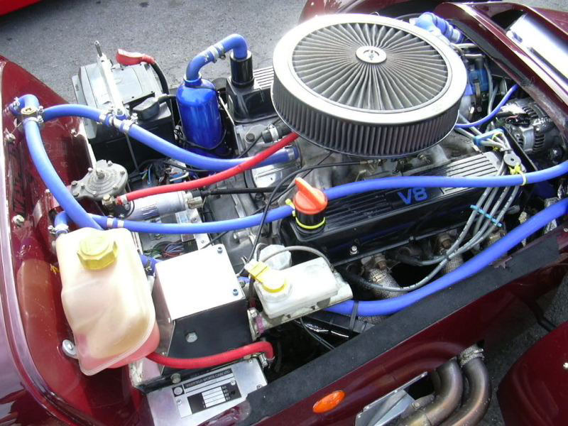

This is Kevin Knight's Seight. It sounds brilliant with it's 3.9 V8 engine. He
previously owned a Pinto powered Westy for 9 years
but last year bought this
beast as he was "smitten by the noise and torque"
Hover over the thumbnails Right) to see larger images (Shows on this page) or click for full image (Opens in new window)
Spec:
- 3.9ltr Rover V8
- Fully adjustable suspension all rose jointed
- LSD (3.62)
- Stage 2 Heads polished & ported
- Mild Kent (200) Cam
- Verniers timing pulley setup, double timing chain
- Weber 4 barrel carb on Edelbrock Performer manifold
- Electronic Ignition
- Westfield heater
- Oil cooler 19 Row x 235mm wide - JIC 10
- John Eales - baffled sump
- John Eales designed Docking radiator - ducted out of front wheel arches
- Pacet 16" fan
- Superleggera Wheels with Yokohama: A48R - 195/50/15 + A32R - 225/50/15
- Craig Davies Electric Water Pump
- Charade alternator
- Mechanical water pump pulley + axel removed - Fan belt size 967a
- Samco hoses
- Willwood 4pot callipers with D Type Polymatrix pad . SPL (Front brakes
- RAC Roll bar (to be fitted)
