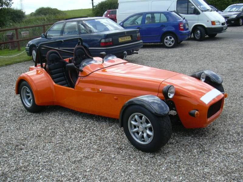

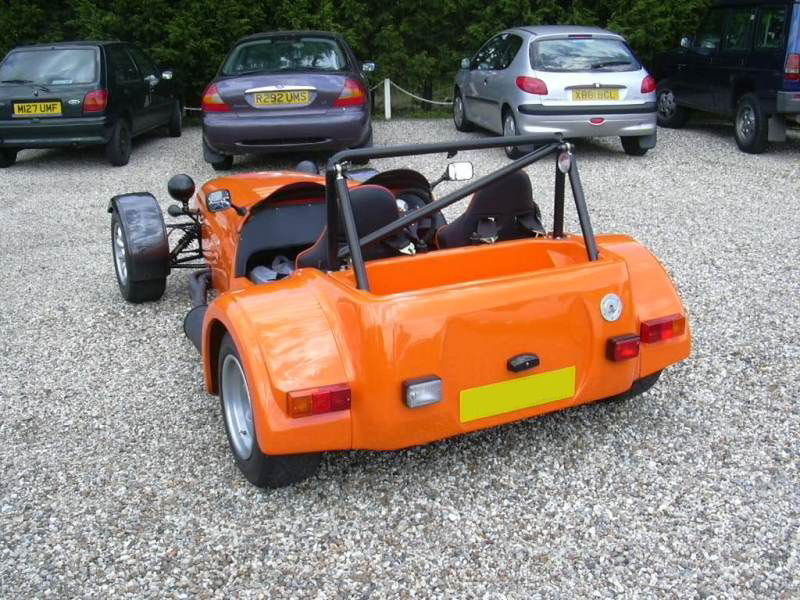

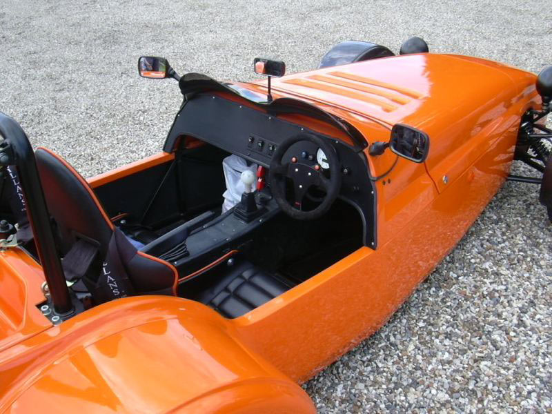

Simon's car is this very bright orange car, also Vauxhall powered but 1600 for a change. He turned up at the June meet with his son who is showing a great interest
in inheriting his dad's car :-)

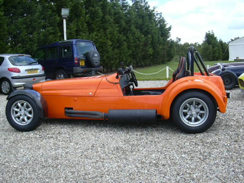

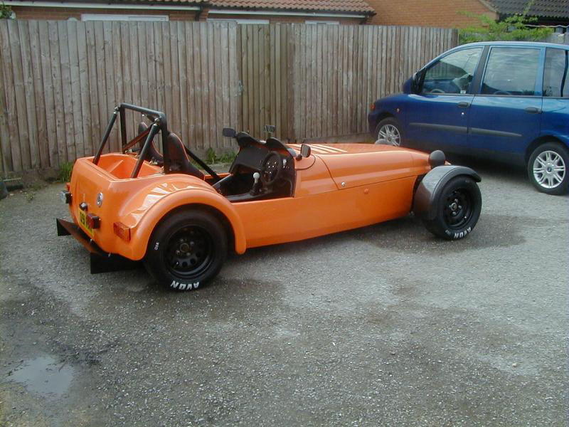

- Car is an SEI Wide with Aero screen.

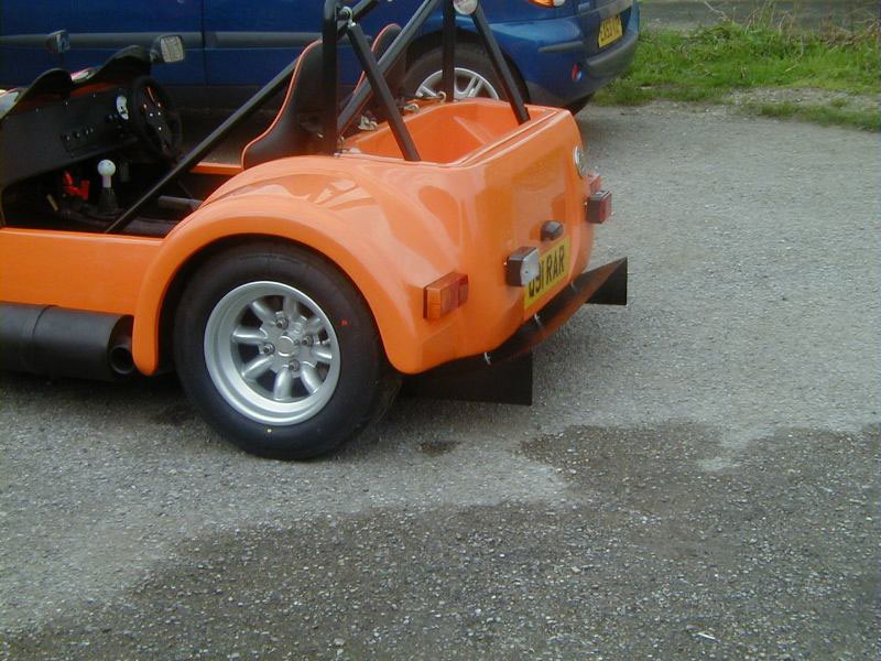

- Wide detachable rear arches (1.75" wider)
- Engine solid mounted in car from bell housing, moved 6 inches further back.

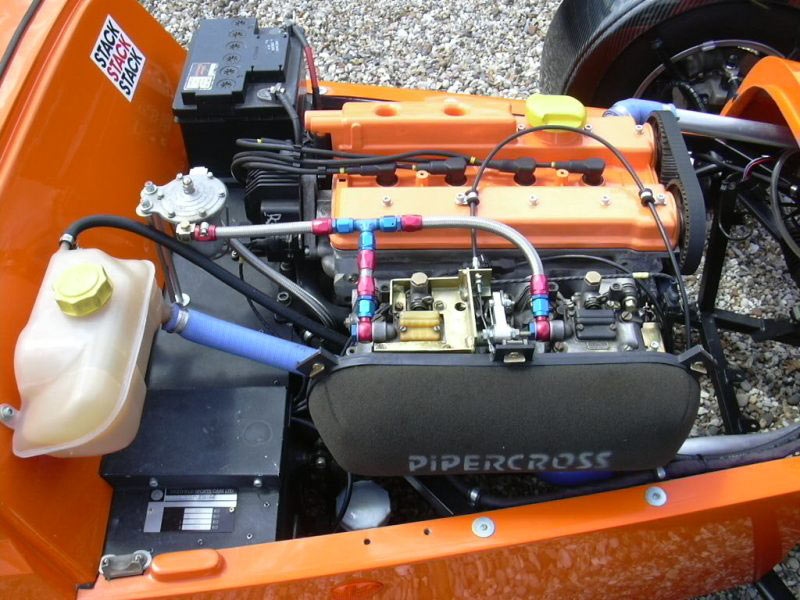

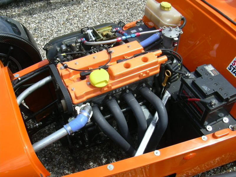

- 1.6 Litre 16 valve Vauxhall engine.
- Standard internals with ARP rod bolts.
- Twin 45 Dellorto's on SBD Manifold.

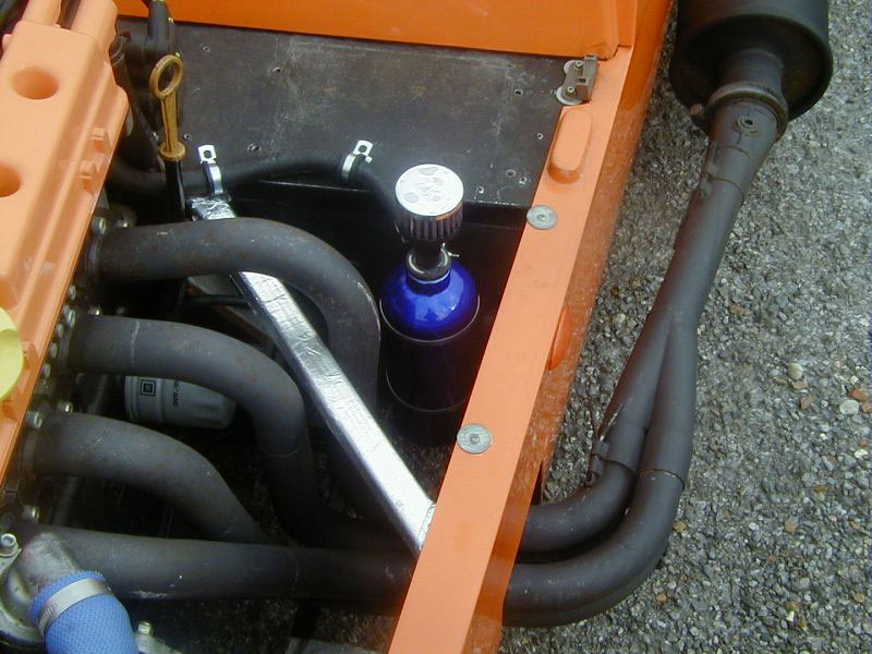

- SBD Exhaust Manifold.
- Wunoff 7" Exhaust can.
- Long input shaft type 9 gearbox. (Capri 2.8)
- Sierra limited slip differential.

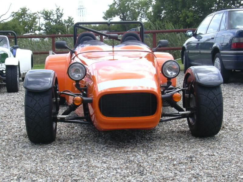

- Front suspension wide tracked by 4 inches fully rose jointed inner & outer ends.
- Rear suspension standard.
- Front brakes 280 mm disc's with aluminium bells & Hipesc Ultralite calipers.

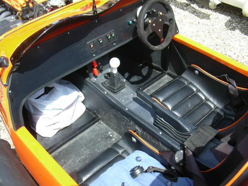

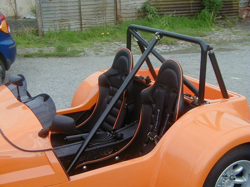

- Westfield padded race seats.

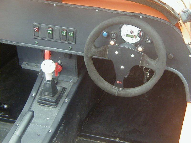

- Dashboard has a Stack gauge.
