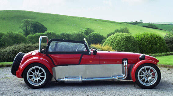

    Build diary and pictures:
      http://www.dfbence.clara.net/ |
History
 Quantum Xtreme E931 NOU  |
Kit ordered:  |
    27/11/99. |
Donor vehicle:   |
     1988 Ford Sierra Sapphire 2.0 LX. |
Donor vehicle purchased:  |
    16/01/00. |
Kit collected:  |
    25/03/00. |
Completed car passed MOT:  |
    24/06/00. |
Completed car passed SVA:  |
    04/07/00. |
Cost of build:  |
    £10,868. |
Approximate build time:  |
    270 hours from kit collection to SVA.  140 hours
since SVA. |
